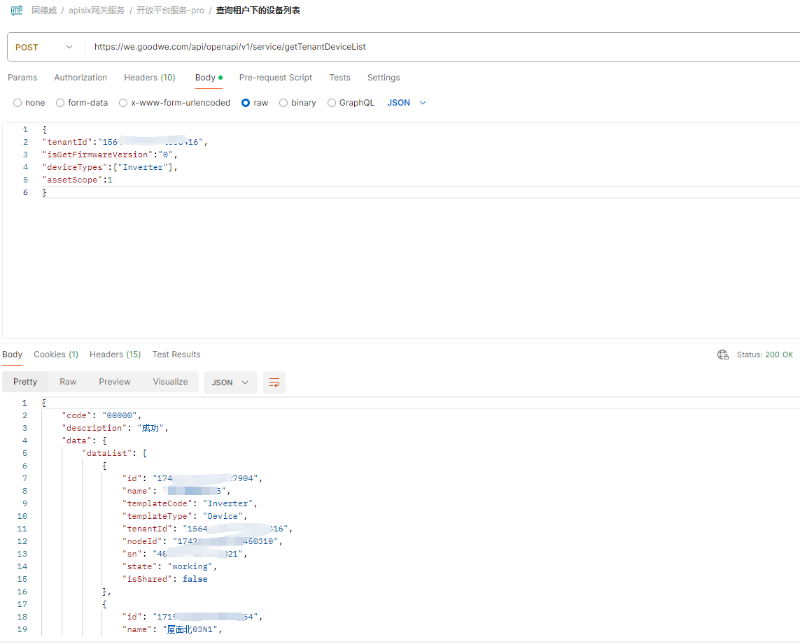

调用示例
请求数据示例
json
{ "assetScope":0, "isGetFirmwareVersion": 0, "deviceTypes": ["Inverter"] }
返回数据示例
样例1:返回租户名下所有设备数据成功
json
{ "code": "00000", "description": "成功", "data": [ { "id": "1462654953121251328", //设备信息 "name": "测试逆变器1", "templateCode": "Inverter", "sn": "smhtestinveter", "tenantId": "1450742399304253441", "state": "1000", "stateName": "运行", "isShared": false, "stationId": "1742449261636855336", "systemId": "1789836820771635200", "attributeValues": [ { //设备固件信息 "attributeName": "类型", "attributeCode": "Type", "attributeValue": "CentralizedInverter" }, { "attributeName": "SIM卡号", "attributeCode": "SIMCardNumber", "attributeValue": "89860481122180046902" }, { "attributeName": "物联卡号后缀", "attributeCode": "SIMCardSuffix", "attributeValue": "1440817956502" }, { "attributeName": "流量", "attributeCode": "Flow", "attributeValue": "100MB" } ] }, { "id": "1450743267489611776", "name": "环测仪-1", "templateCode": "EnvironmentalTester", "tenantId": "1450742399304253441", "sn": "8100KHTU208G0010", "isShared": true, "state": "1000", "stateName": "运行", "stationId": "1742449261636855336", "systemId": "1789836820771635200", "attributeValues": [ { "attributeName": "类型", "attributeCode": "Type", "attributeValue": "CentralizedInverter" }, { "attributeName": "逆变器额定功率", "attributeCode": "RatedPower", "attributeValue": "8000" }, { "attributeName": "出厂日期", "attributeCode": "PackagDate", "attributeValue": "2021-10-20T08:39:07.499Z" }, { "attributeName": "投运日期", "attributeCode": "RuningDate", "attributeValue": "2021-10-20T08:39:08.464Z" }, { "attributeName": "机型", "attributeCode": "Group", "attributeValue": "Storage" }, { "attributeName": "支架型号", "attributeCode": "BracketModel", "attributeValue": "22" }, { "attributeName": "SIM卡号", "attributeCode": "SIMCardNumber", "attributeValue": "89860481122180046910" }, { "attributeName": "物联卡号后缀", "attributeCode": "SIMCardSuffix", "attributeValue": "1440817956510" }, { "attributeName": "流量", "attributeCode": "Flow", "attributeValue": "100MB" } ] } ] }
